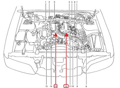

whear is the knock sensor locate on a 1999 q45 thank you

should have 2 knock sensors. left knock sensor is below left side of intake manifold while right knock sensor is below right side of intake manifold.
