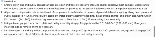

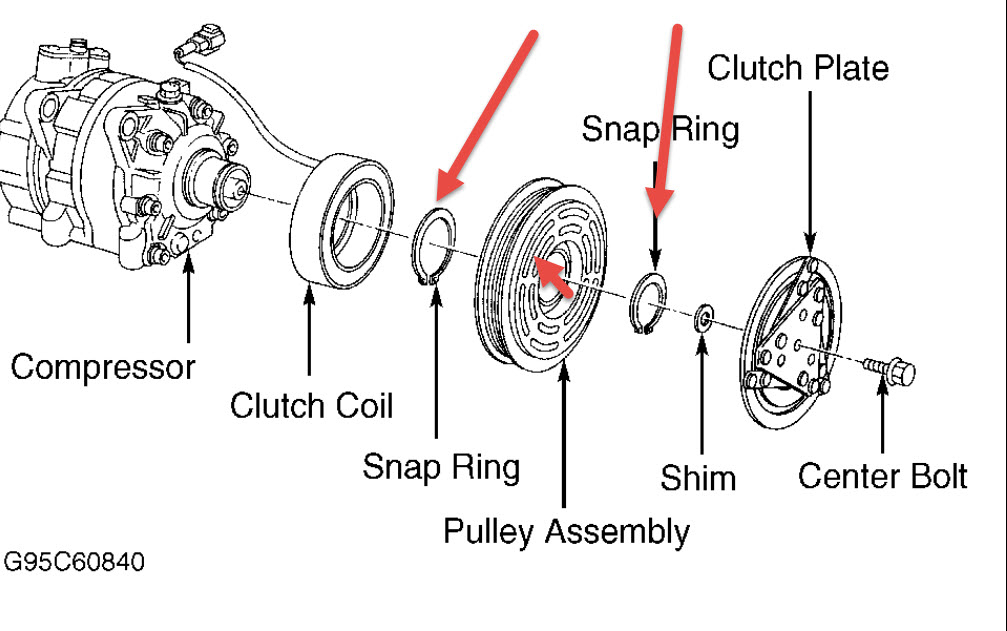

My air conditioner compressor bearing was making a lot of noise with air conditioner on or off so i got a bearing for it as I pushed the old out the out side of it stayed in pulley. It is very thin any idea how to get it out or is it a lost cause and I need to buy a new compressor? Also I really needed the car so put it all together except the compressor and the belt it runs on its own belt it runs fine but my power steering pump has started making noises. Is it because one less belt on the crank pulley or is it just going out on its own at bad timing?

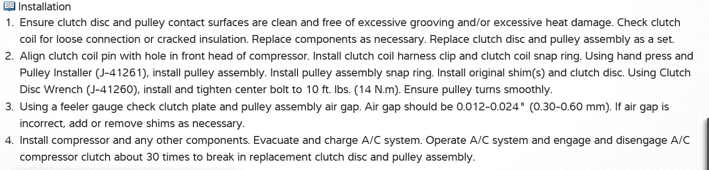

check the belts and tensioner, recommended replacement is 60,000 for both that might be the power steering noise you hear. as far as compressor, the power steering may be on its way out, but try a belt first as they slip when they get old due to low tension. as for compressor I think you are replacing clutch bearing which there are two snap rings involved and must be removed so bearing can come out. the clutch must be adjusted to proper distance however or will burn up see pictures.. if it actually the compressor bearing just get a rebuilt compressor it is not worth replacing bearing on compressor.
