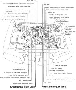

Hi dragon8227,Welcome to 2carpros and TY for the donation. Knock Sensor location
https://images.2carpros.com/forum/automotive_pictures/12900_ksl_1.jpg
https://images.2carpros.com/forum/automotive_pictures/12900_ks_24.jpg

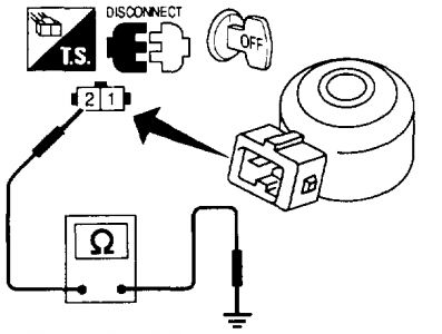

COMPONENT INSPECTION Knock Sensor 1.Disconnect knock sensor harness connector. 2.Check resistance between terminal (2) and ground. Approximately 500 - 620 KOhms [at 25 °C (77 °F)] *It is necessary to use an ohmmeter which can measure more than 10 MOhms. CAUTION: Do not use any knock sensors that have been dropped or physically damaged. Use a new one.
