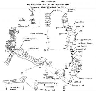

what makes my two front wheels lean inward on the top and also would like to know why my car hesitates when i take off and is sluggish and is their any common problems in this car i've had it for 12 yrs and really love it cant figure it out thank you very much for your help

Hi johnnydi, The wheels leaning inwards at top indicates camber problem and they could be due to wear of the upper and lower control arm bushes and links.
https://images.2carpros.com/forum/automotive_pictures/192750_FrtSuspension94Q45Fig01_1.jpg
Sluggish performance can be due to various possibilities and mostly it should be related to engine tune-up. When were the spark plugs and related items last checked?
