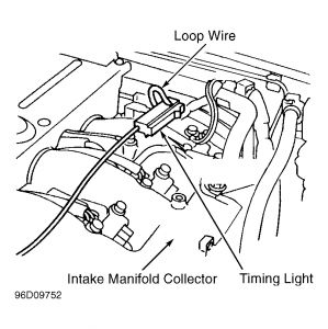

Were are the spark plugs at
HENRYBJOHN
  • INFINITI
1996-Q45 with, 160,000 mils engine size 3.0
and when driving up a bridge I have to gang speed before going up.I change the gas filter under under the hood, and that did not help, do you have a picture were the sparks plugs go
thank j. Henry
Georgetown, S.C
:oops: :oops:
Friday, September 7th, 2007 AT 7:29 PM
MERLIN2021
  • 17,250 POSTS
You have cops under the hood! Coil on plug! what did ya think I meant?
https://www.2carpros.com/forum/automotive_pictures/62217_Plugs_1.jpg
You unsrew the hold down screw and lift the COP then pull you plug!
