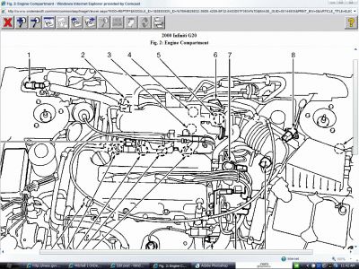

Where is the IAC Valve located, and how do I remove this item to clean it.

It's on the throttle body, 2 bolts usually hold them on...an electrical connector plugs into it...seems the site isn't showing email addresses anymore...I will post picture, don't know how much detail you will get! Look at #5...
