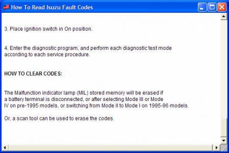

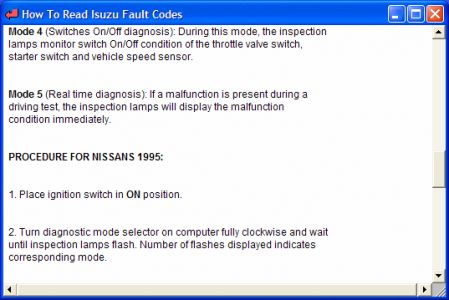

My Infiniti M30 with automatic 3 speed with overdrive
being 4 gear. while driving down the road it kicks down
to 2nd gear. before this happens the speedometer
quits working and the tach goes crazy. while driving
my speedometer starts to drop and then I know
it is going to kick down to second gear.After this happens the speedometer doesnt work at all.
I get no engine errors.

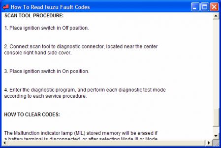

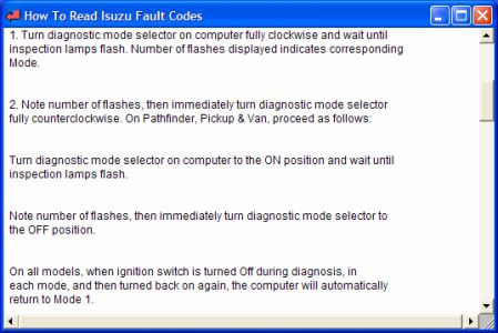

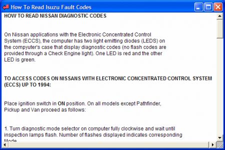

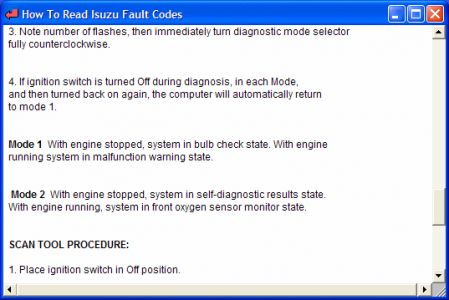

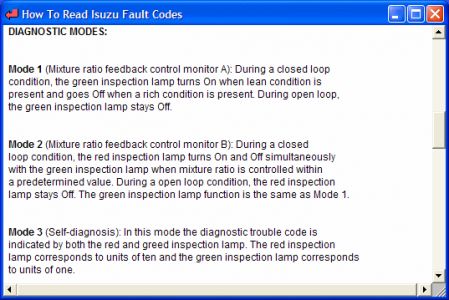

Do this to read codes.
https://images.2carpros.com/forum/automotive_pictures/62217_1_20.jpg
https://images.2carpros.com/forum/automotive_pictures/62217_2_20.jpg
https://images.2carpros.com/forum/automotive_pictures/62217_3_22.jpg
https://images.2carpros.com/forum/automotive_pictures/62217_4_11.jpg
https://images.2carpros.com/forum/automotive_pictures/62217_5_6.jpg
https://images.2carpros.com/forum/automotive_pictures/62217_6_3.jpg
https://images.2carpros.com/forum/automotive_pictures/62217_7_2.jpg
