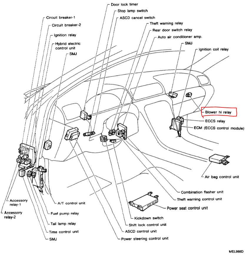

My Blower Motor Will not come on I am trying to replace the relay and cannot find the location.

The blower relay is located under the passenger side dash (behind the glove box).
Keep in mind that the relay is the first item to check, but it can also be due to a bad motor or a resistor.
I have attached diagram for your reference.
