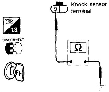

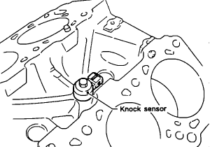

where is the egr valve, and knock sensor located, and how hard are they to replace and clean myself

1994 Infiniti J30 V6-2960cc 3.0L DOHC (VG30DE) Knock Sensor Location
https://images.2carpros.com/forum/automotive_pictures/12900_ks_1.gif
Located in the engine block valley. Knock Sensor Connector

1.Disconnect Knock Sensor sub-harness connector. Knock Sensor Test
https://images.2carpros.com/forum/automotive_pictures/12900_ks2_6.jpg
2.Check continuity between terminal (a) and ground. Continuity should exist. If no continuity exists, inspect Knock Sensor sub-harness. If sub-harness is OK, replace Knock Sensor. EGR Valve And Temperature Sensor Location
