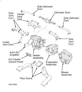

I just bought this car, and the owner told me that the blower motor is out. I hear it click when i try to turn on heat and nothing comes out. I'm pretty handy and would like to know where i could find instructions on replacing it. I heard it's a pain, but i have the time. Any suggestions?

Mitchell doesnt have any R&R instructions for the blower motor in that vehicle, says to use thefollowing diagram as a guideline. The labor guide only shows 1 hour to do it, so it cant be too difficult.Looks like it is located under dash on passenger side.Once you remove the lower panel you should be able to see it.From there, just unscrew mounting screws and remove the blower.
https://images.2carpros.com/forum/automotive_pictures/1639_inf1_1.jpg
