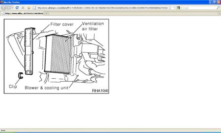

Please advise location of cabin air filter in I-35 and how to replace it.

REPLACEMENT PROCEDURE 1. Remove glove box. 2. Remove instrument lower panel from instrument panel. 3. Remove filter cover fixed clip. 4. Slide the filter cover to the upper side and then remove it. 5. Take out the ventilation air filter from cooling unit. 6. Replace with new one and reinstall on cooling unit. 7. Reinstall filter cover, clip, instrument lower panel and glove box. There you go.
