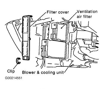

I know the cabin air filter is someplace behind the glove box, but I can't see how to remove it.

Remove glove box and lower instrument panel then C clip of filter cover
https://images.2carpros.com/forum/automotive_pictures/198357_Graphic_702.jpg
