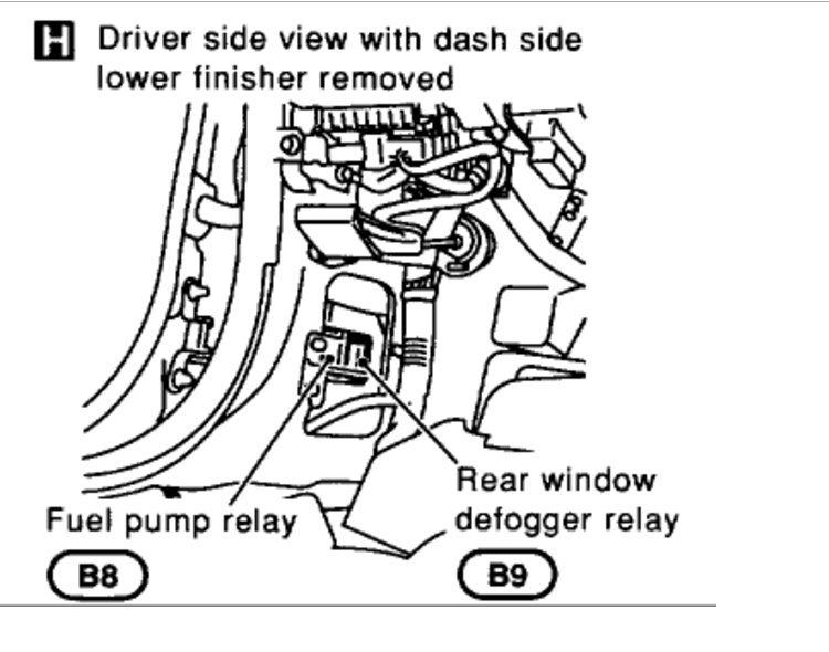

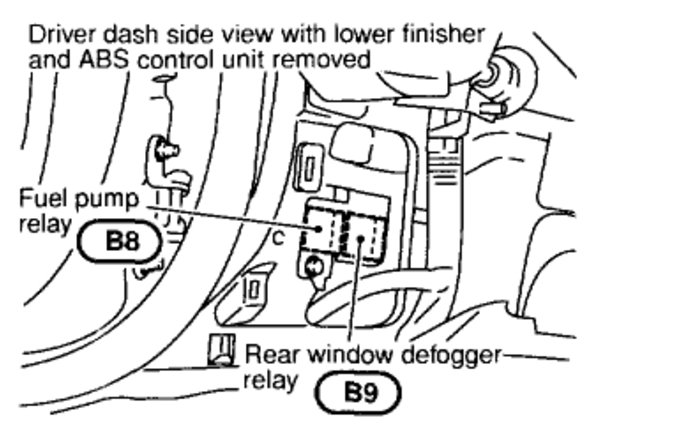

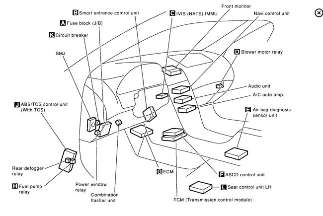

Need schematic and exact location of fuel pump relay.

The fuel pump relay is located in the kick panel on the drivers side, Here is a guide and some diagrams (below) to help you fix the problem.

see attached pic
