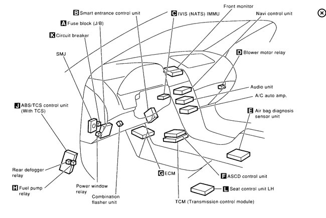

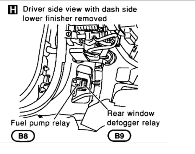

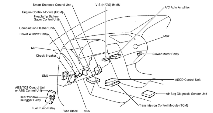

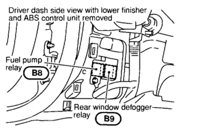

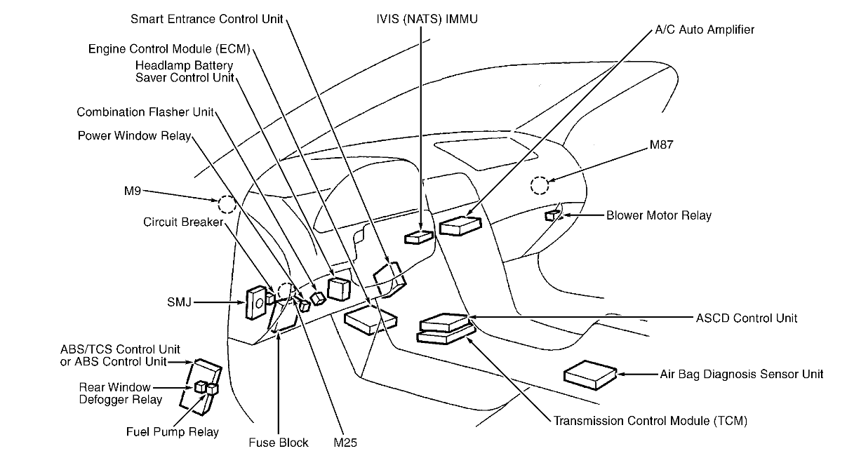

Need schematic and exact location of fuel pump relay.
Apr 11, 2010 at 7:30 AM
  • 55,327 POSTS
The fuel pump relay is located in the kick panel on the drivers side, Here is a guide and some diagrams (below) to help you fix the problem.
