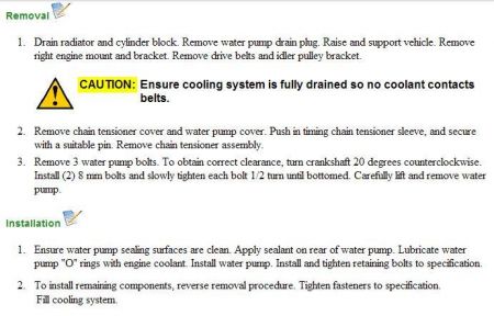

2000 Infiniti I30 Water pump replacement
2000 INFINITI I30
127,000 MILES • 6 CYL • 2WD • AUTOMATIC
ORLANDO NOVICE
I believe I need to replace the water pump as it is leaking and the engine temp spikes.
I have read about having to turn the pump 20 degrees clockwise to remove it, and 20 degrees counterclockwise when reinstalling.
I have replaced the starter, alternator, and radiator on this (or my 2001 I30), so I do have some mechanical ability.
Am I over my head on this one?

https://images.2carpros.com/forum/automotive_pictures/261618_Noname_1819.jpg
