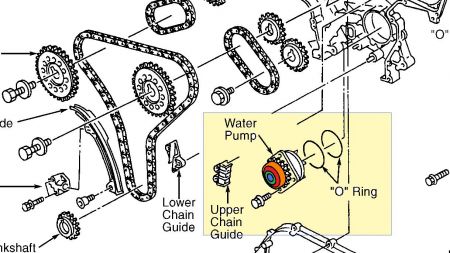

Hi, can u help me 1st locate the water pump? 2nd whats the best way 2 change it because I heard it might deal with the timing chain is that true?

Its NOT a job that I suggest for you to do
but you can be the judge of that
timing chain may need to be moved and set aside
drain coolant
raise and support car
remove right engine mount and braket
remove belt
remove idler pulley and bracket
remove chain tensioner cover
remove water pump screws

good luck here what i have for pictures
https://images.2carpros.com/forum/automotive_pictures/99387_i30_1.jpg
