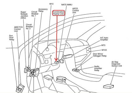

my turn signals dont work or do my hazards ....so my question is where is my signal relay are signal flasher?

your combo flasher relay unit is located behind dash, right of the steering column *picture below*
