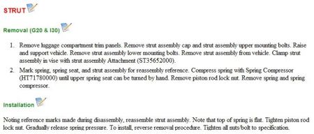

How to remove rear seat and replace rear struts?
