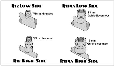

Sounds like you're talking about the low and high side test ports-does it look like this:
https://images.2carpros.com/forum/automotive_pictures/12900_ac_service_fittings_18.jpg
Sep 6, 2009 at 7:23 PM
BURRCHRIS
yes it does.
