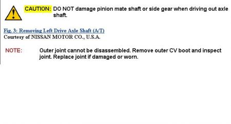

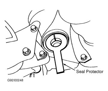

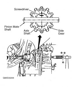

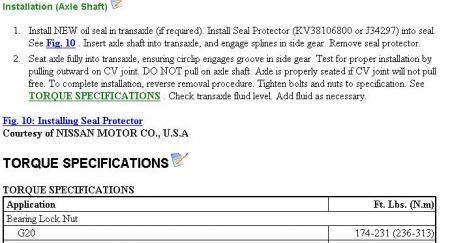

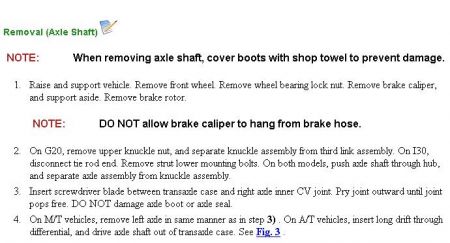

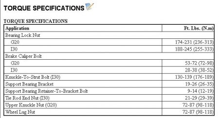

I need to replace both Cv joint assemblies and i want to do this myself...how long should this take and are there any bits of advice on doing it?
Feb 17, 2009 at 3:44 AM
ZACKMAN
  • 4,202 POSTS
If you have never done CV axle replacement, plan on doing it on a Saturday morning to mid-day. A seasoned technician can do both in a bout 1.5 hours including prep and cleaning afterward. Get a Haynes or Chilton (Haynes is more user-friendly for non gearhead). They have more pictures to each step than what we can provide.
