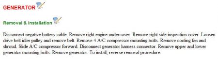

I need step by step instructions to remove and then replace the alternator on a 1997 Infiniti I30....SUPER FAST!!!
Thanks!!

https://images.2carpros.com/forum/automotive_pictures/261618_Noname_716.jpg
