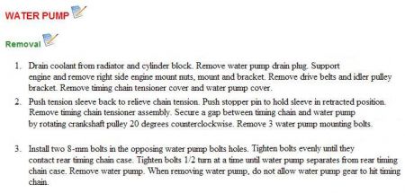

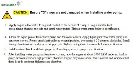

How do you replace the water pump on it?
Saturday, October 17th, 2009 AT 12:16 PM
