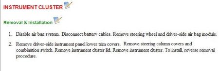

How do I access the strument cluster. My speedometer works intermitly, if I push just right on the display it will work for a short time.

https://images.2carpros.com/forum/automotive_pictures/261618_Noname_1255.jpg
