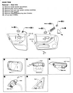

How to remove door panel?

https://images.2carpros.com/forum/automotive_pictures/170495_door_panel_1.jpg
There is no 94 i30. This is a 94 j30 and the 96 i30 i think is similiar. HTH.
