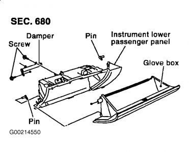

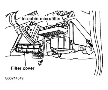

how do you replace the in cabin air filter on a 2007 infiniti g35

if you have one Remove instrument lower passenger panel and glove box. Remove the filter cover, then remove the in-cabin microfilter. Take out the in-cabin microfilter from the blower unit. Replace with new one and reinstall on blower unit. Reinstall the instrument lower passenger panel and glove box.
