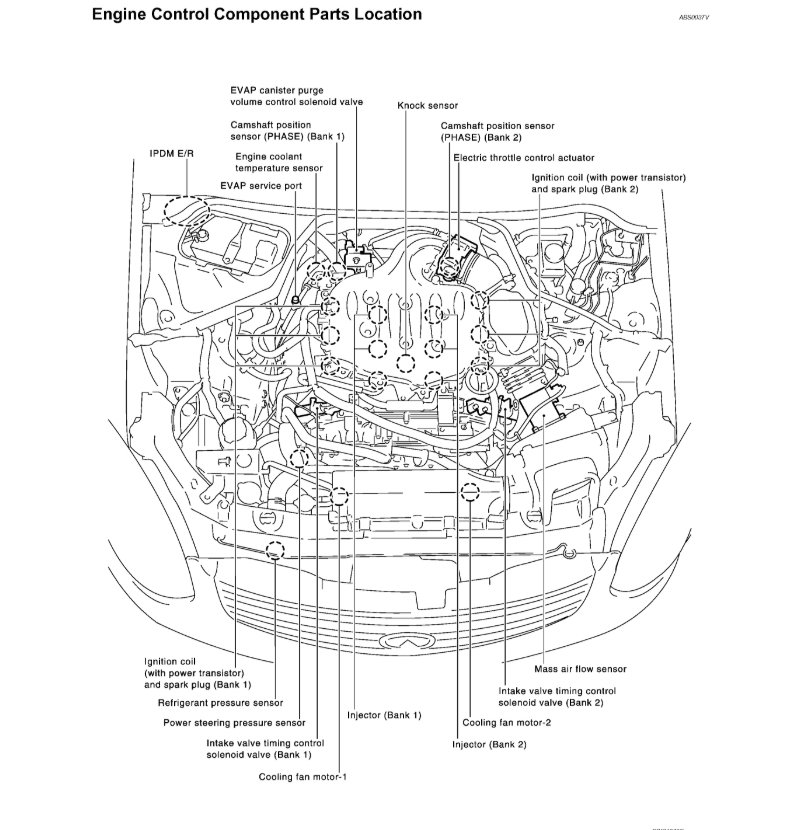

As I'm driving, the temperature gauge on my 2005 Infiniti G35 just started to rise and fall from normal to near the top of the gauge, triggering the cooling fans. It doesn't appear to be overheating but it never did this before. Coolant level is correct, serpentine belt is fine, and the water pump is not making any noise.
Bad coolant temp sensor? thermostat? any ideas?
Oct 7, 2009 at 5:05 PM
IMPALASS
  • CAR REPAIR CONTRIBUTOR
  • 3,112 POSTS

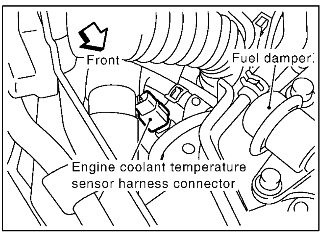

It sounds like the coolant temperature sensor needs to be replaced. Here are two guides to go through and the location of the sensor below.

I went to Autozone, there are no codes displayed, everything seems to be okay. After driving for a while, with the engine hot, I checked under the hood, and noted the following: the coolant in the reservoir is at the proper level, but cold. The upper radiator hose is hot, but the lower one is cold. Very little heat coming out of the vents with the heat turned all the way up. The temp gauge spikes up close to the top but the car doesn't seem to be overheating. The gauge fluctuates up and down from center to top slowly but frequently.
Any ideas?
thanks
