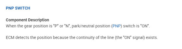

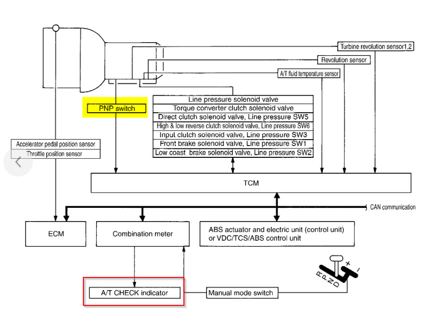

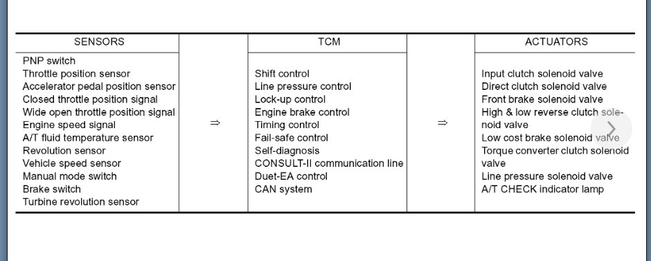

ABUBAKAR ABBA
the gear indicator went blank. AT check light is stationery on the car refuse to start.
Jul 30, 2020 at 9:47 AM (Merged)

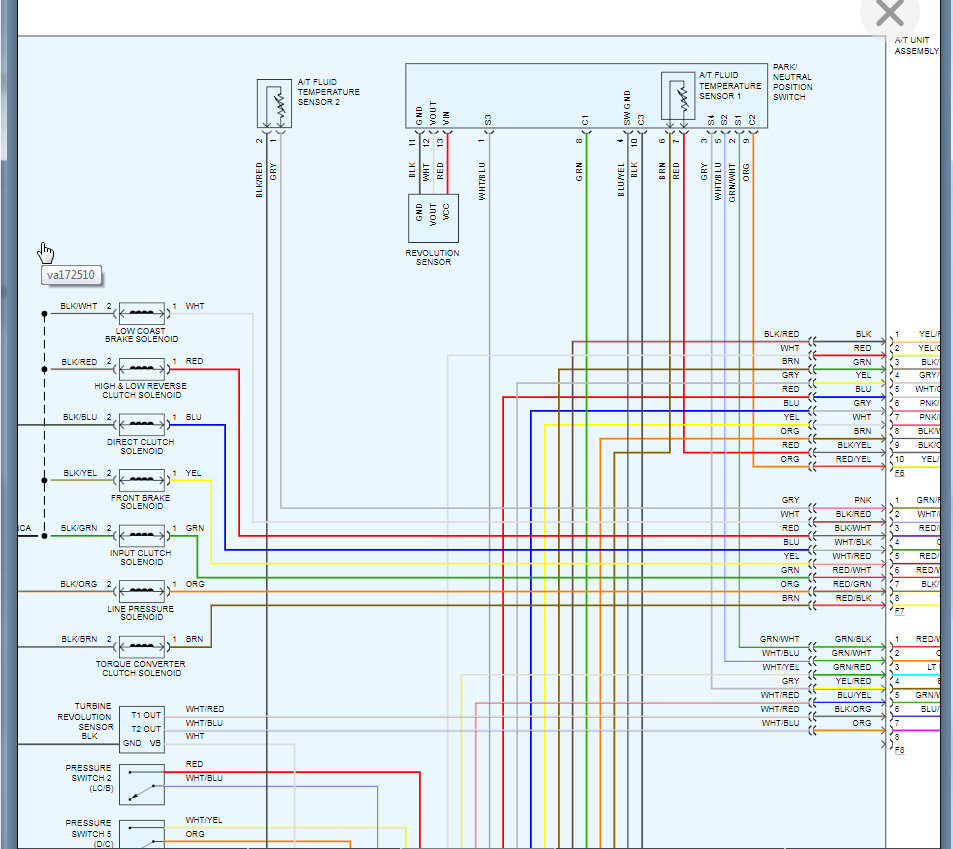

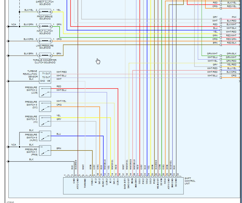

Most likely this is an issue with the park neutral switch. Basically this is what tells the transmission control module that it is in park or neutral and it is okay to start.
We need to start with checking for codes to see if we have any thing there pointing us to a specific place. I suspect we will and then we can perform that testing. If you can't pull codes, then most parts stores can get them free of charge. The issue clearly is getting the vehicle to them so they can do it. However, we need codes to make sure we are testing and replacing the proper components.
Let me know what you find and we can go from there.

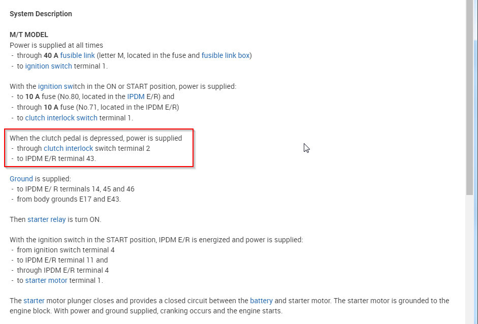

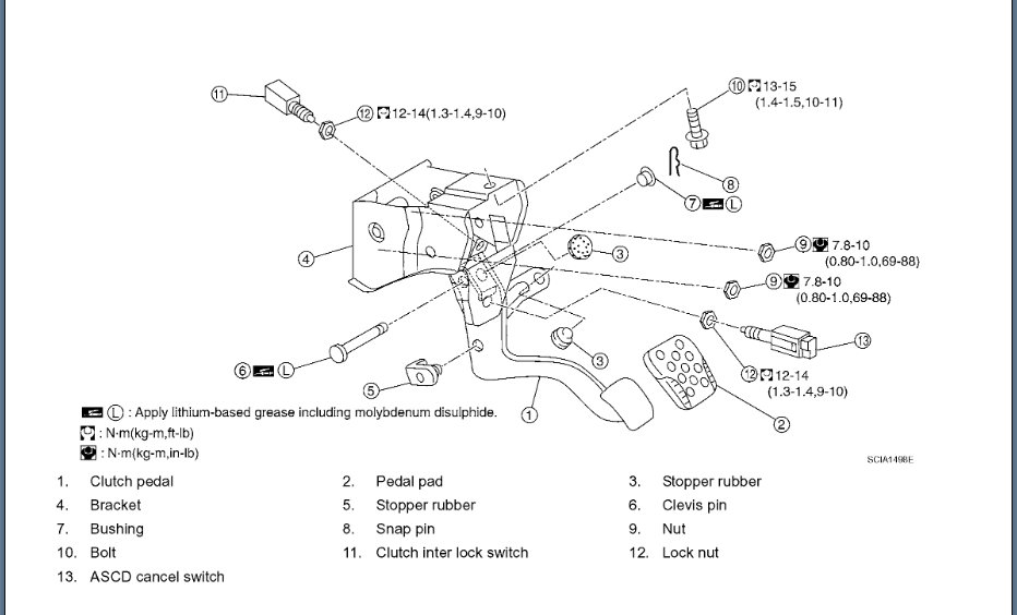

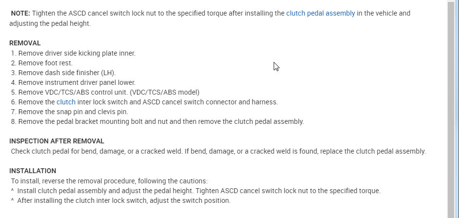

JASON BRANCH
I just got given the car listed above and he said the battery was dead and the clutch was shot. I charged the battery for a good while and gave it a good crank. About one turn in it died completely, door lights, radio, dash light, The whole 9 yards. My friend then mentioned to me how he took at somewhere and they said how the clutch had a sensor in it to detect if the clutch was bad and would not allow it to start. I can’t find anything online but maybe you guys could help. thanks
The only thing that would be close to this is called the clutch pedal position switch. This can prevent the start but it does not detect if the clutch has failed.
The position switch (inter lock switch according to Infiniti) just tells the PCM if the clutch is depressed and if it is it allows the engine to start.
Sounds like to me that you have a failed battery and I would suggest changing that first and then retest the operation of the rest.
At the very least we need to have the battery load tested. If the car doesn't start you can remove the battery and take it to a parts store and they will test if free of charge.

Mine was doing the same thing recently. Do your VDC, Slip, and SES lights ever illuminate when the car does this? A very common problem on these cars are bad camshaft and crankshaft position sensors. My car had your intermittent "no start" condition for awhile before it started throwing codes. I replaced the left (passenger) bank camshaft position sensor 3 months ago and the problem hasnt resurfaced. It seems that most folks with this problem have to replace the same sensor, but I have seen it be the right bank sensor and/or crankshaft position sensor too. Hope this helps if you haven't already fixed it!
