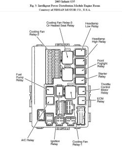

Air conditioning kicks on and off - mostly off. I can see the a/c clutch ingage but never more than 10 seconds.. A/c pressure is good, seems like a relay. So, where is the relay?

Hi rhue, Thank you for the donation. The relay is A/C relay in the IPDM, in engiune compartment. Was the freon topped up prior to this occurring? What is the low and higfh pressure reading? Did you check the pressure switch?
https://images.2carpros.com/forum/automotive_pictures/192750_IPDM03InfinityG35Fig03_1.jpg
