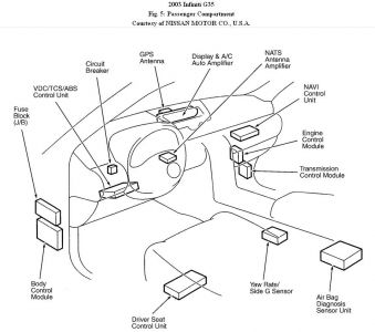

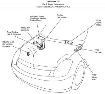

2003 Infiniti G35 6 cyl Two Wheel Drive 82000 miles
INTERIOR LIGHTS
None of the interior lights work, the bulbs are good, I think its a fuse but can not find it . Where is the fuse block and fuse located?

Hi kdgrego, Here are diagrams for the ocations of the fuse boxes.
https://images.2carpros.com/forum/automotive_pictures/192750_Components03InfinityG35Fig02_1.jpg
https://images.2carpros.com/forum/automotive_pictures/192750_Components03InfinityG35Fig05_1.jpg
Check fuse # 1 and 21 ( 10 A) in fuse block behind left kick panel. Fuse F ( 50 A ), Fuse and Fusible Link block, right rear side of ngine compartment.
