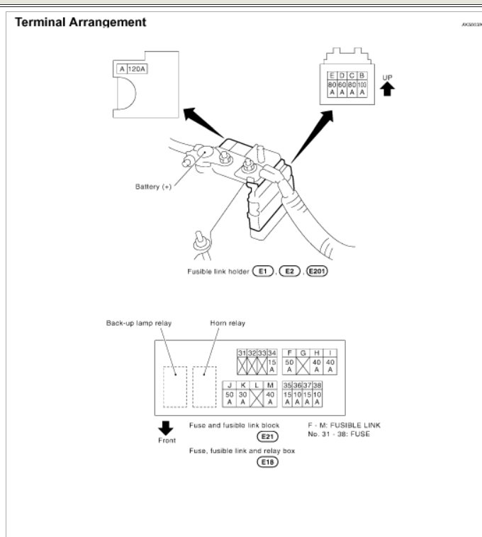

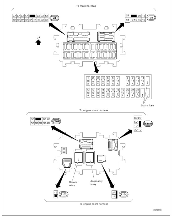

Im trying to replace the horn relay fuse, but I can not get the old one out. How do u remove the horn relay to replace it?
Mar 11, 2008 at 8:25 PM
SSSSSS1
Is pull the thing out. it next to the battery, take the cover of that covers the battery and then take off the fuse box cover and pull out the horn relay. i believe its all the way on the left hand side of the fuse box.

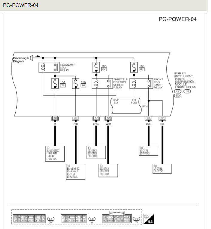

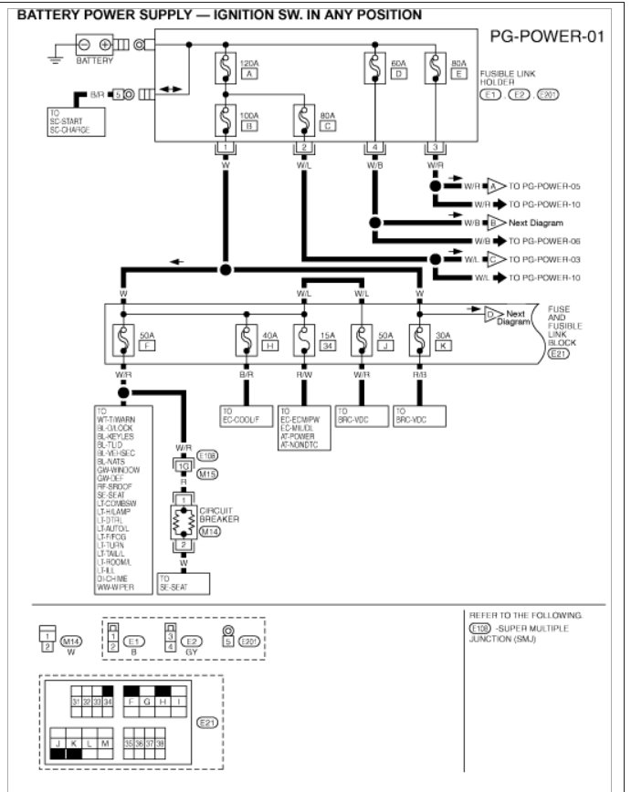

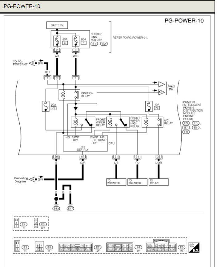

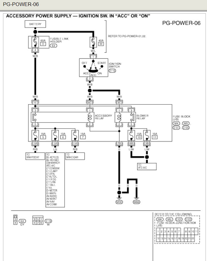

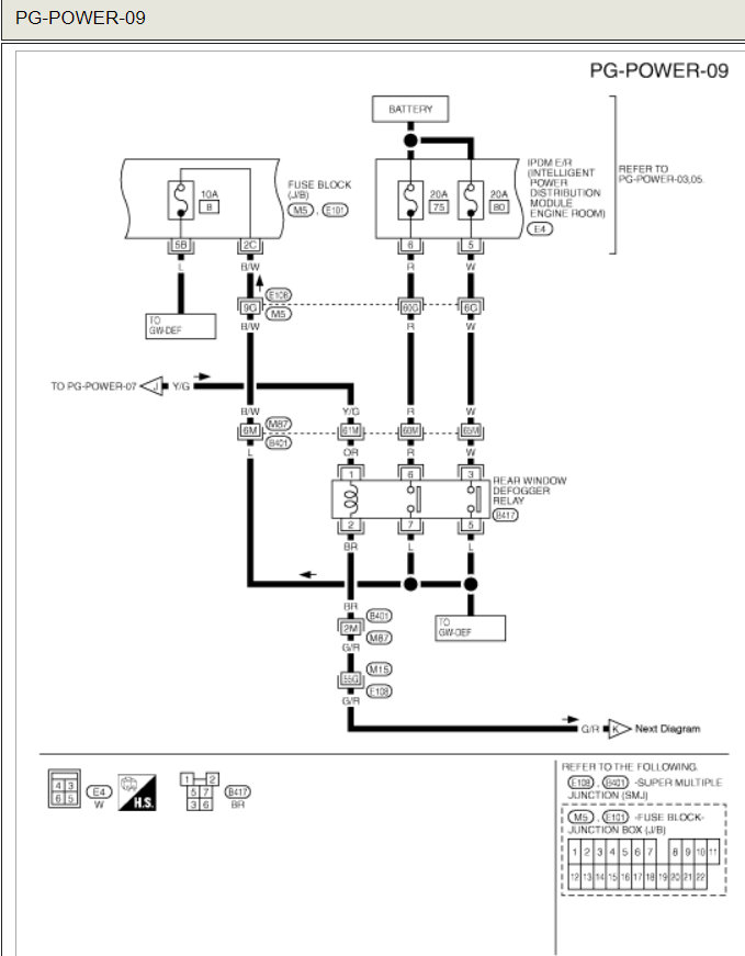

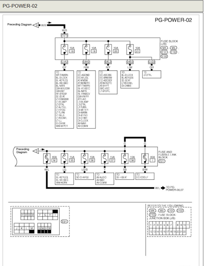

Here is a guide to help and the location in the fuse panel diagrams below.
