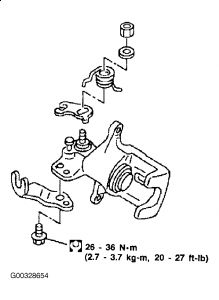

due to the parking brake cable, i can't get the caliper off the rotor. how do i remove that cable? i want to know which bolts i should remove to get that cable off so i can remove the caliper.

Hi Remove return spring,toggle lever and cable guide. see diagram
https://images.2carpros.com/forum/automotive_pictures/198357_Graphic_325.jpg
