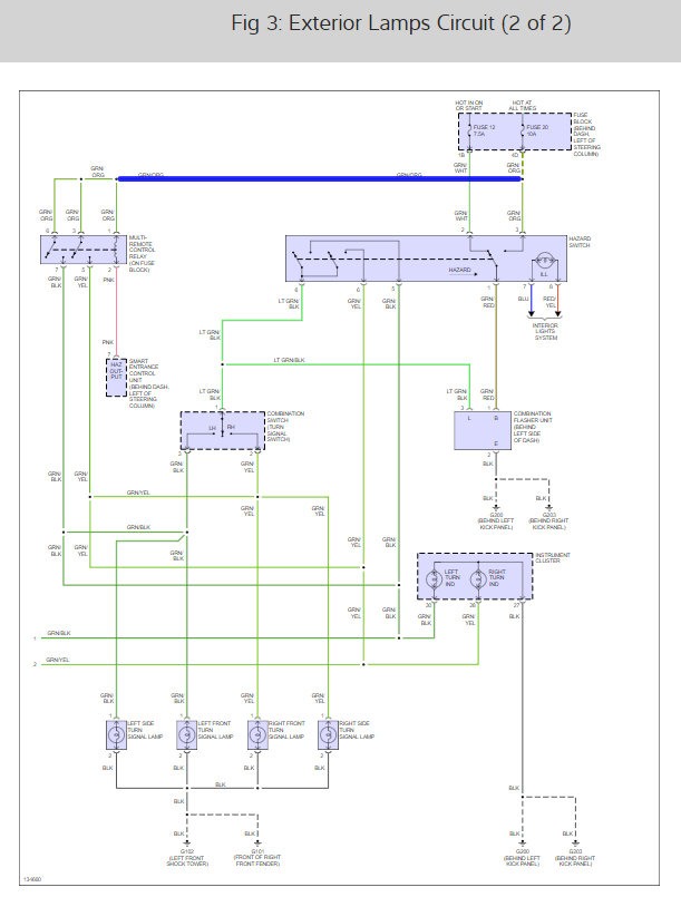

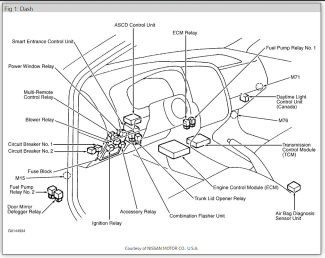

My turn signals have stopped working and so has my hazard switch. It seemed like a gradual failing of something electrical because it stopped for a little, then came back, then it stopped permanently. I know it is not a housing connection problem because they still flash when I lock my car remotely, therefore it is not the bulbs either. I have checked my fuses and they are fine. I was told told to check my relays but I have no idea how to do so, so if that is your suggestion, where can I find them on my car? Your help is greatly appreciated.
Dec 13, 2009 at 5:10 AM
BLUELIGHTNIN6
  • 16,542 POSTS

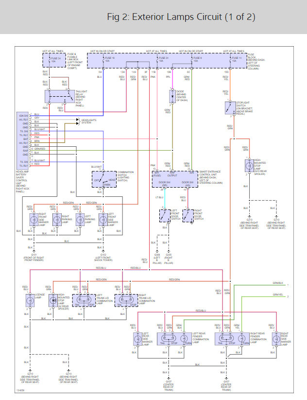

It sounds like the flasher unit is not working right, but to be sure here is a guide to help you test for power to see where you are losing it and the blinker wiring diagrams so you can see how the system works:
They call it a combination flasher.
Cheers
Dec 13, 2009 at 11:58 AM
SILVER WOLF
I had this problem and checked things out using these guides and diagrams the flasher fixed it.
