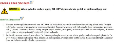

How to replace rear brakes on my Infiniti G20
Do I need a special tool to retract the piston?
How do I retract the piston?

How do I retract the piston on the rear brake caliper?

use C clamp to retract piston into caliper
