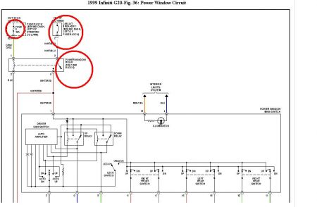

The power windows and power door locks just stop working, none of the go up or down. I checked all the fuses and relays they seem fine. Can you give me some suggestion of what could be the problem.Maybe I missed a relay but only one 30Amp fuse was labeled power windows.

Fuse Block (Behind Dash, Left Side of Steering) Fuse #8 10A Circuit Breaker 1 Power Window Relay

Thank that worked

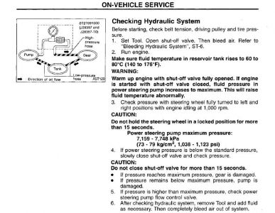

Now my power steering hose keep slipping off or bursting . I have change the power steering pump and replace all the pressure hoses and it still happen. What can be causeing it to Burst or build all that pressure.

Perform the hydraulic system check per Factory Service Manual. If you ask me, I suspect your steering gear is defective. As explained, if pressure reaches maximum pressure (you said the hoses keep bursting - too much pressure), gear is damaged.
