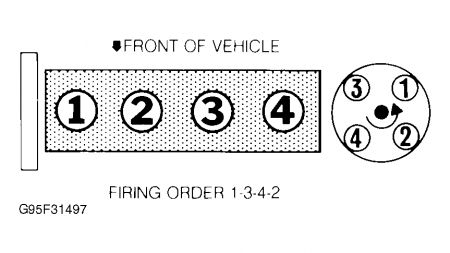

what is the order to hook up the spark plug wiers? and if connected right and it still won't start what could it be?

Ask yourself these questions. Do you have spark? Pull #1 spark plug and check spark intensity. Do you have fuel? Full tank of gas. No, that is not what we are looking for. Do you have sufficient amount of fuel pressure at the fuel rail?
