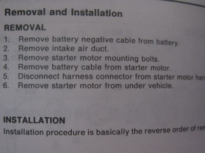

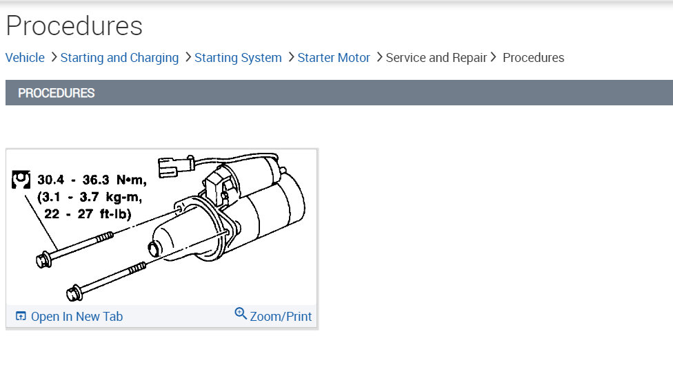

Start by disconnecting the battery and raising the car up safely. Here are three guides that will help you get the job done by seeing what you are in for when fixing your car.
and
and
Remove or disconnect the following:
Negative battery cable
Starter insulator
Starter harness connector and cable
Starter mounting bolt and nut
Starter
To install
Install or connect the following:
Starter. Torque the bolts to 27 ft. lbs. (36 Nm). Starter harness connector and cable
Starter insulator

Try this.

In order to remove the starter, you need to remove the air cleaner on top of the engine and remove the two bolts basicly by feeling for them (make sure you have a good selection of extensions and wobbles, then jack the car up and remove the two wires, it then can be guided down. i have done it 3 times now.

First off never heard of removing a starter to lubricate anyway here you go. First remove the positive starter cable then you remove the wires from the back of the solinoid (make note of what bolt or screw they came off from). Then remove the two bolts. They are removed from the starter side so the top bolt may not be able to be seen you will probably need to go by feel.

My manual says a) "remove the air intake"; 2) undo two bolts.
When I got under the car, I can see the starter, but the bolts are screwed in from the engine's side.
I cannot see bolts from under the car. I undid the air intake hoses.
There is a mess of the hoses behind the engine where starter is supposedly located.
Any pointers are appreciated.
