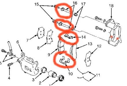

Without seeing the rotors it is hard to answer. It is best to replace both when doing a brake job and I don't have a problem with that being done. Without seeing them I can't say. It keeps a flat surface on a flat surface. Where I have trouble is that you paid for new rotors less than a year ago and you now have compromised rotors. Our shop would have replaced them at our cost or at no charge more likley. I would be very curious at what thickness they are now at. The discard thickness is .787" You don't usually get one machining out of a rotor anymore. At the very least this shouldn't have been charged in my opinion. The most common problem with premature brake wear is from faulty installation.
https://images.2carpros.com/forum/automotive_pictures/30961_xbrakes_1.jpg
These areas are crucial to good operation. They must be cleaned and lubed with the correct grease. IF not these ares stick and brake pads may do various things. One pad sticking and not returning, one pad may stick at one end and pivoting the pad so the pad wear uneven etc. Binding is more typical of poor workmanship. I'm not convinced you needed the hoses and perhaps not the calipers...but I would have to see them to know. IT sounds like this should have been a warranty issue to me. See if the still have the parts.
