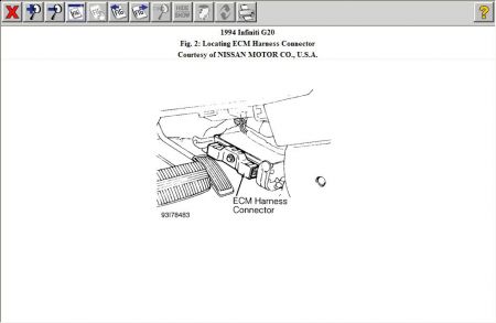

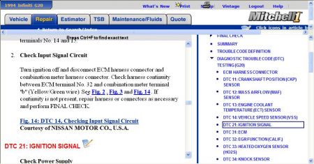

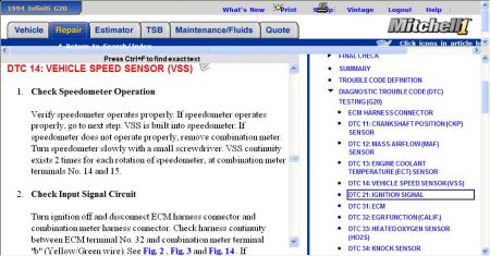

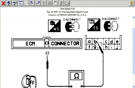

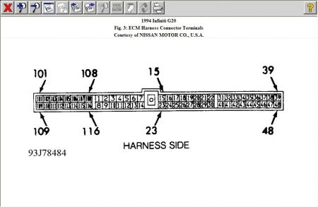

Hi Edg20,Welcome to 2carpros and TY for the donation and selecting us as your auto repair site. Feel free to ask questions at anytime- I will go at the VSS

From your feedback, It looks like you believe that the VSS is bad not the Gauge Cluster.
Is there a way I could check this or is it best to go to someplace like AAmco or the dealer to have the VSS checked?
The Diagrams you had with the email were hard to read.
Jan 6, 2010 at 7:55 AM
  • 75,992 POSTS
I recommend you take it to the dealership they the ones that have the proper tools and testing equipments-
someone else thought it might be the VSS, If they scan the computer for code/s and came up with DTC 14, however it wasn't done so its a guessing factor-again bring it in.
