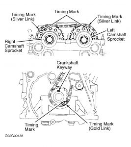

I replaced the rear cam and am trying to set the timing. Need to know how to do it.... Have a semi-mechanic friend helping, but he needs the timing marks or a diagram or something to finish... Please help

Hi there, Thank you for the donation, Cam timing pics. Mark (mhpautos)
https://images.2carpros.com/forum/automotive_pictures/61395_Graphic_90.jpg
