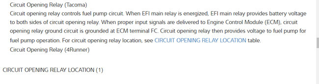

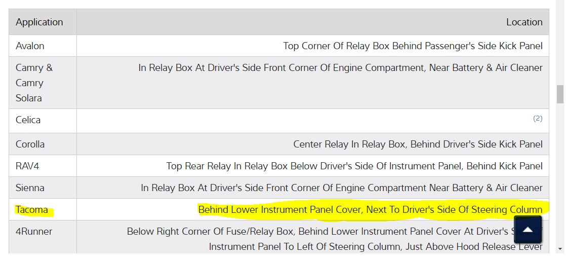

My mom ran over a curb and seriously scraped the bottom. Won't start. Where's the inertia switch in the truck listed above?
Sep 4, 2019 at 3:01 PM
SCGRANTURISMO
  • 4,897 POSTS
There is no Inertia Fuel Cutoff Switch for your vehicle. I have included a description of your vehicle's fuel system for you in the diagrams down below. What exactly is your vehicle doing when you try to start it?
