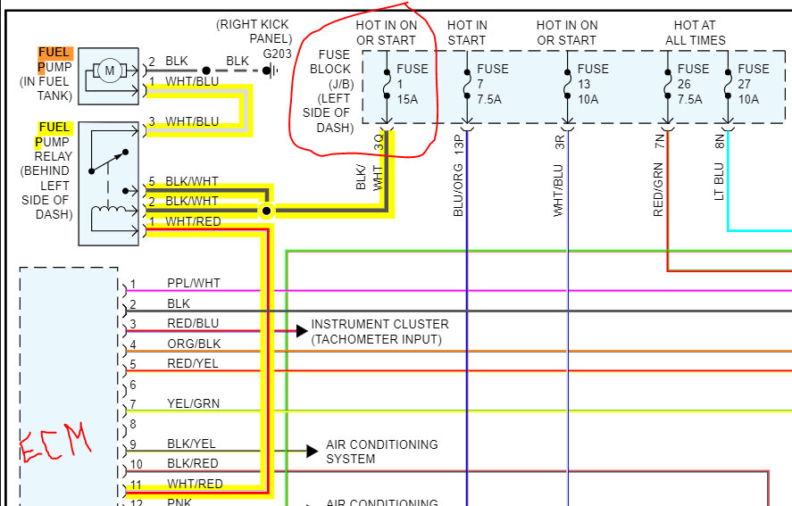

I'm looking for the location of the inertia reset button on my vehicle?
Aug 17, 2023 at 2:59 PM
  • 110,193 POSTS
This vehicle doesn't have one. That is commonly found on a Ford product.
What is happening? Is there anything I can do to help? If it is a fuel-related issue, I attached a portion of the wiring schematic so that you have a reference. Poser from fuse 1 in the fuse box (left side of the dash) provides power to both the primary and secondary sides of the fuel pump relay. The ECM provides a ground path completing the circuit and power then travels to the pump.
See pic below.
