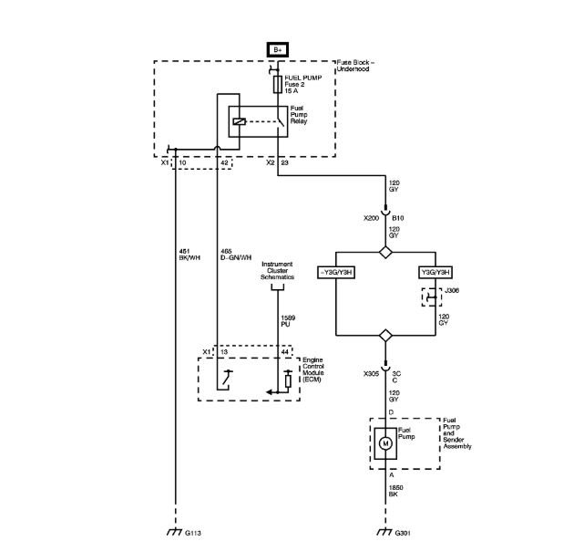

Having trouble understanding and finding out where it is located in. What all you have to do to get to it?

Good morning.
There is no inertia switch on GM. That is for Ford systems.
I attached a wire diagram for you for the fuel pump system. Verify the fuses are good by checking for power on both sides of the fuse.
Image (Click to enlarge)
