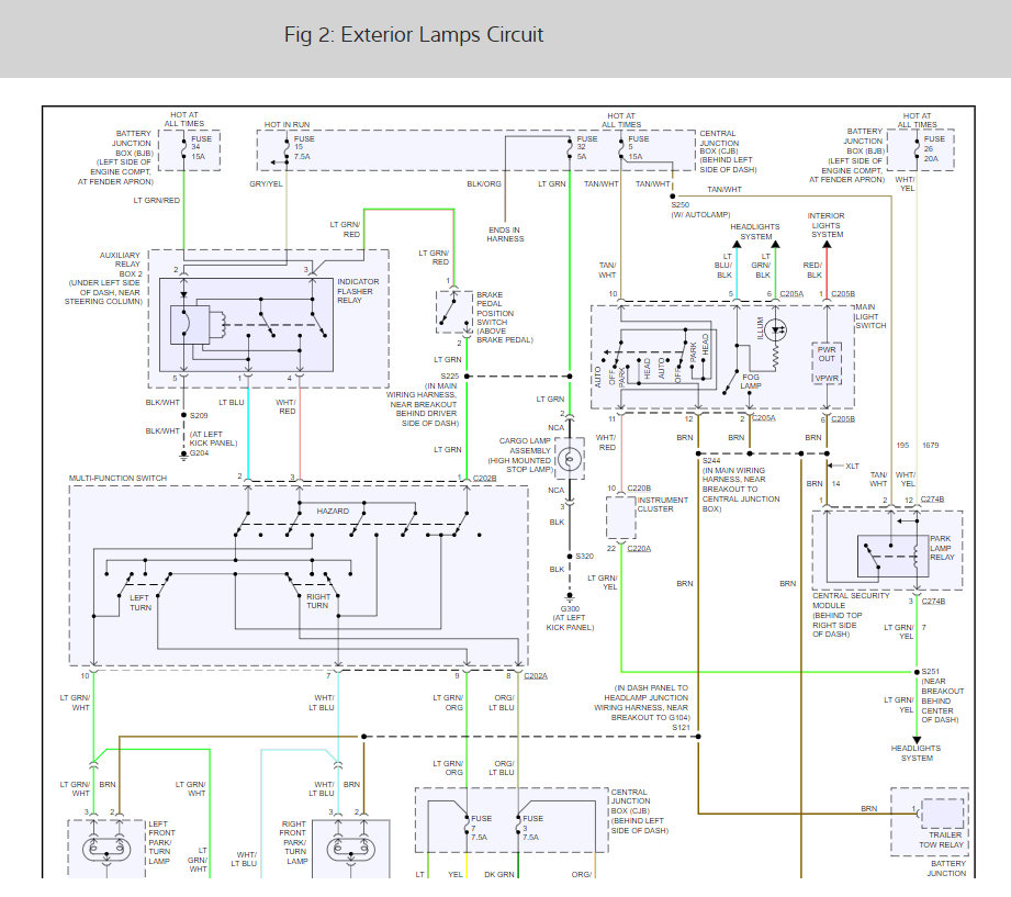

The bulbs are good, the fuses are good, and I replaced the flasher relay, however; the problem persists. When I activate the turn signal, the icon does not show and there is no ticking sound. Any advice?

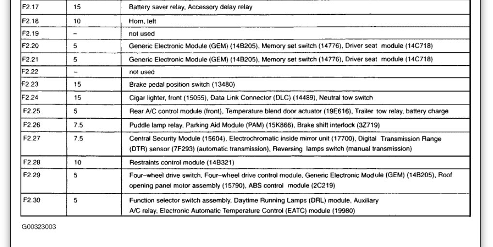

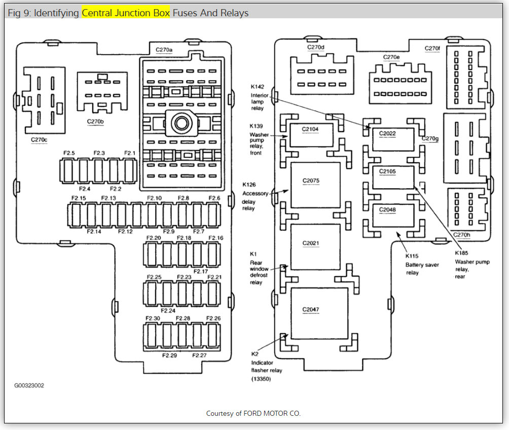

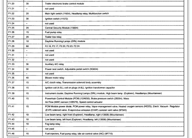

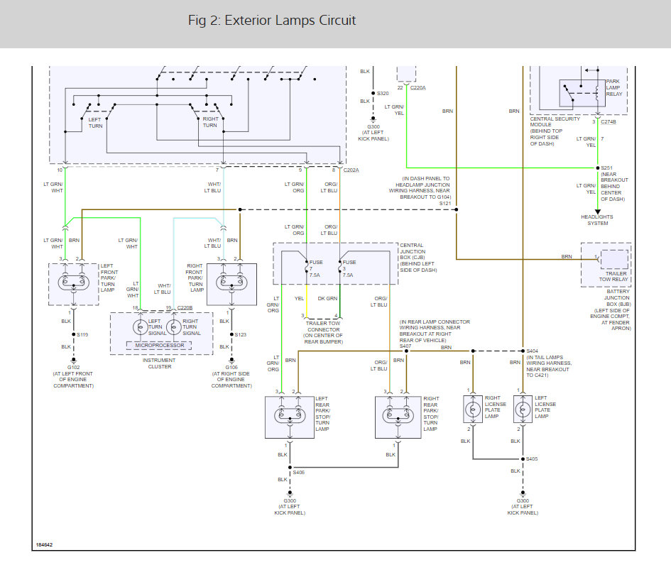

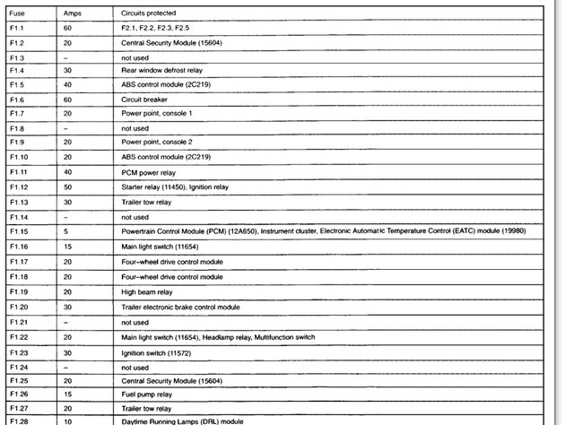

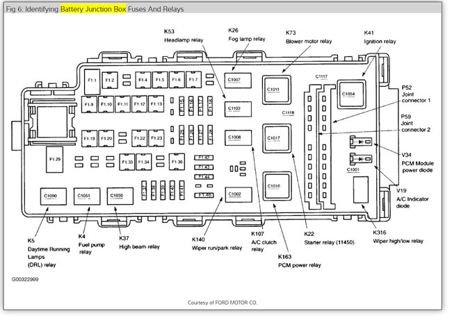

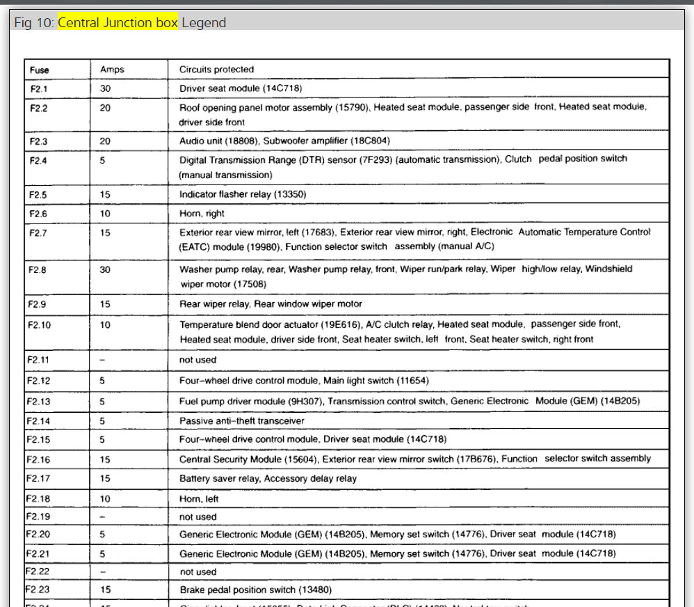

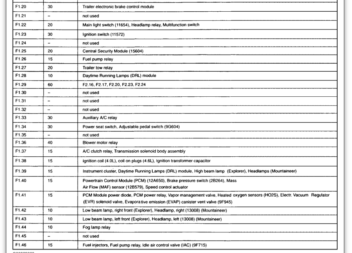

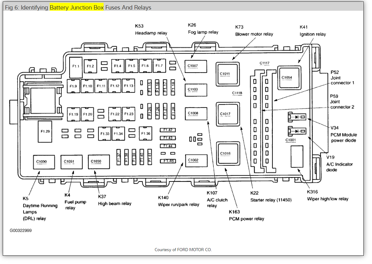

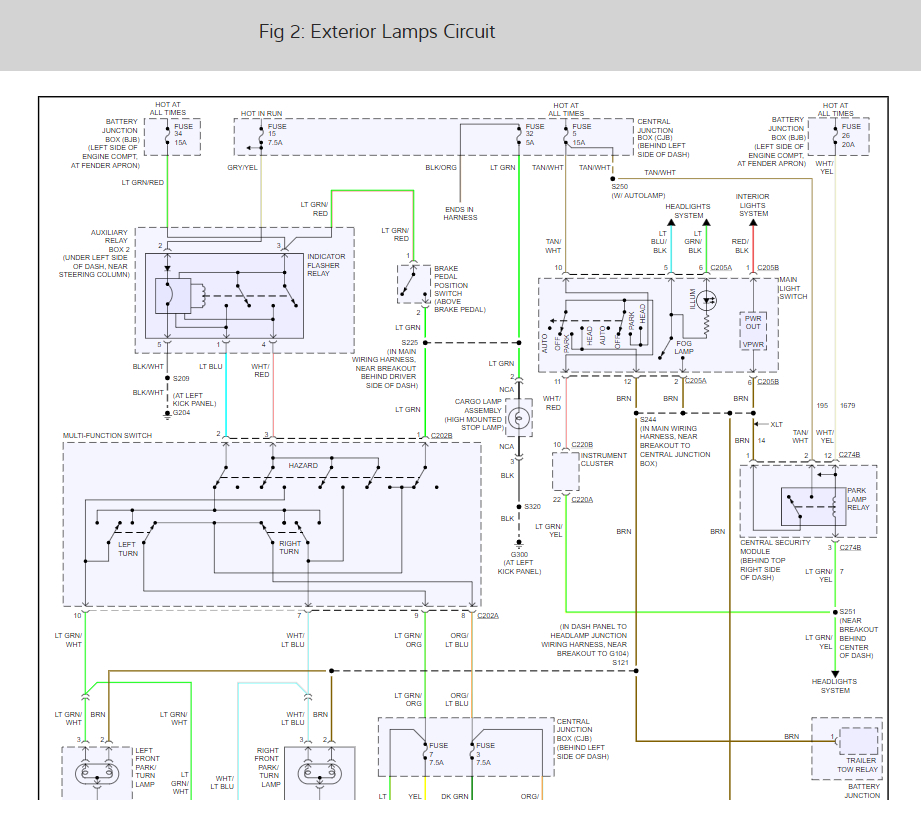

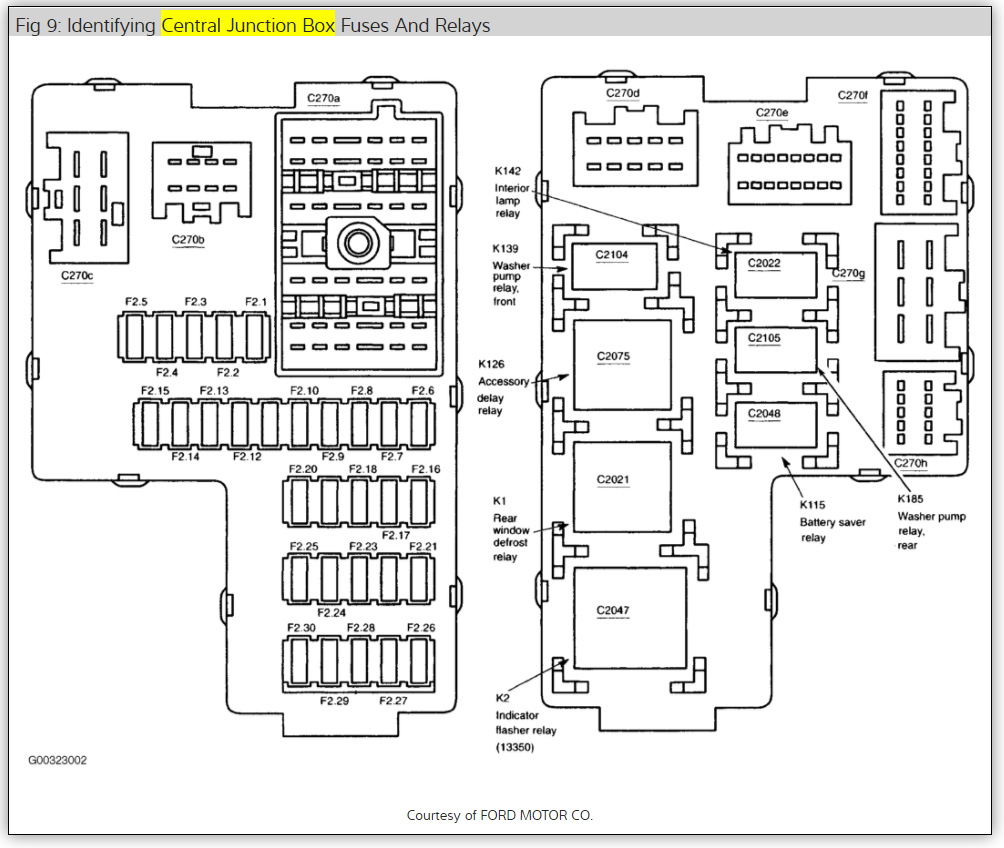

Do you have power at fuse #f1.34? this is what powers the flasher. here is a blinker wiring diagram so you can see how it works and a guide to help you check for power at the fuse with the fuse location as well:
Check out the diagrams (below). Please run this test and get back to us.
