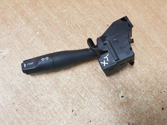

Can someone please tell me how to remove the INDICATORS CONTROL STALK 1X43-13335-AF from a 2007 Jaguar X-Type ? I found one instruction on You tube but the switch looks different then the one on my car. I will try to provide a picture of what the one in my car looks like for reference.
Thanks for any help provideded!
Note: the reason I'm removing it is because the bright lights will not stay on, so I assume it's a problem with the indicator control stalk.

Yes, you are correct, the high bean toggle is worn out. Here is how to replace the switch which will need the steering column cover removed. You might need to lower the column slightly to remove the covers, also disconnect the battery before you begin. They don't show much on it in Alldata, so if you upload images of the problem if you run into any, I can help step by step. Check out the images (below). Let us know how it goes.

I have the top and bottom panels off, but I can't see how the turn signal stalk disconnects from the steering column? The diagram you provided doesn't show this and I'm not sure what Item 3 and Item 4 is? I need a detailed diagram of how to remove the Indicator Control Stalk (1X43-13335-AF) from the steering Column. Let me know if I'm missing something. Thank you for your help!

No problem, can you upload images of the switch in the column? With Jaguar they don't give us much info for some reason. There should be a mounting screw holding it. Please upload an image so I can help.

Thanks KEN L! All i had to do was flip a small switch on top and it came right out. Now to get another one.
