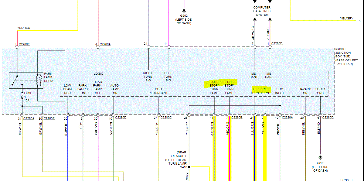

Turn signal flashes too fast
2009 FORD FUSION
60,000 MILES • TURBO • 2WD • MANUAL

Emergency lights working normal.
Feb 19, 2021 at 7:23 PM
  • 110,240 POSTS
Oftentimes, the flashers will blink fast if one of the bulbs is bad. Have you checked that? It will flash normally on hazard, but double time when signaling.
As far as a flasher, this vehicle doesn't have a traditional flasher. It is controlled through what is called the smart junction box (SJB) which is in the vehicle (driver's side). If you look at the pic I attached, it shows the SJB. I highlighted the signal power supply. Note there is no flasher relay. Check all bulbs. Also, let me know if it is both sides or only one side.
