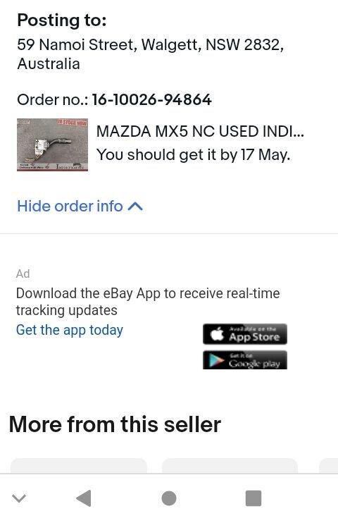

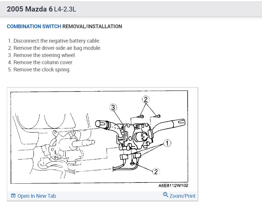

I have indicator stick for Mx5 NC Mazda, but I have a Mazda 6 Gy 2005 model. will the part fit in the GY?
May 10, 2023 at 3:32 AM
  • 55,845 POSTS
It is unlikely that the indicator stick for an MX5 NC Mazda will fit a Mazda 6 GY 2005 model. While both vehicles are produced by Mazda, they are different models with different specifications and parts.
May 10, 2023 at 6:14 AM
KEISHAMB
This is the one I have bought.
May 10, 2023 at 10:14 AM

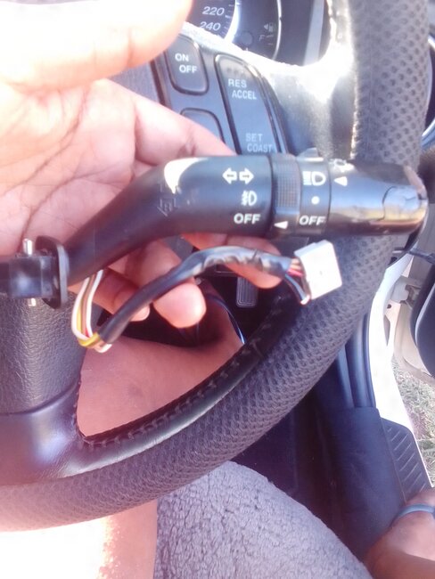

KEISHAMB
This is the one that's broken :(
May 10, 2023 at 10:15 AM
  • 55,845 POSTS

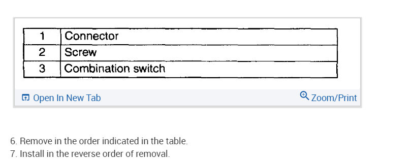

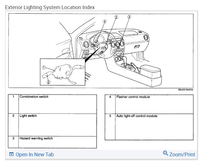

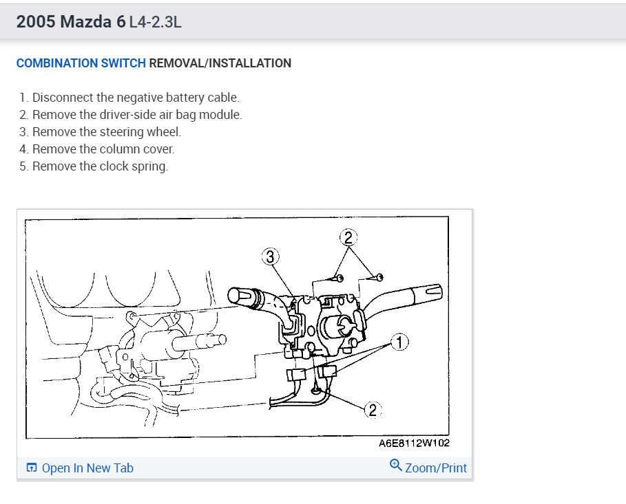

This is called a "Combination Switch" here is how to replace it in the images below. Check out the images (below). Please let us know if you need anything else to get the problem fixed. It doesn't look like you have the correct part.
