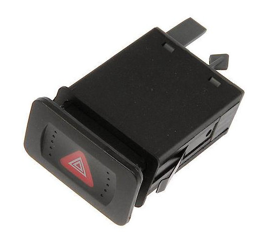

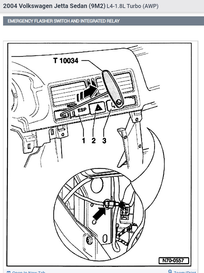

One of the common causes of this non blinking turn signal is a malfunctioning flasher relay.
On this vehicle the turn signal flasher relay is integrated with the emergency flasher switch mounted on the dash.
I have attached diagram below for your reference.
