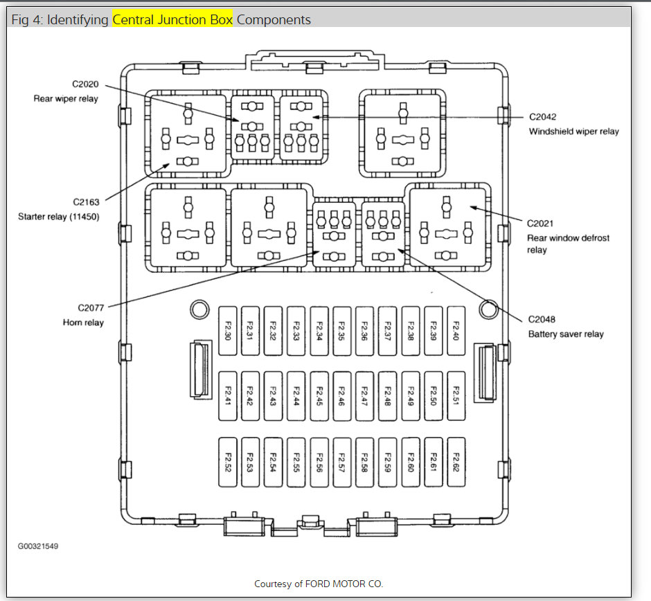

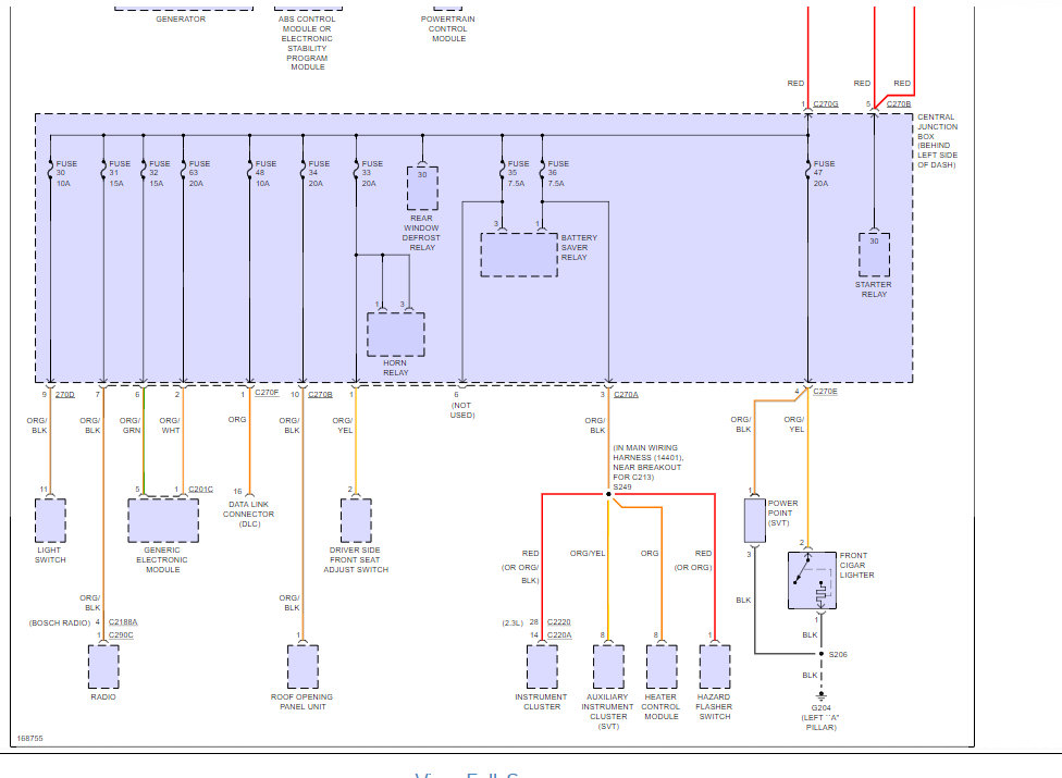

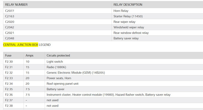

when I turn the key off, the oil light and airbag light stay on. also, if you turn the radio on it will keep turning on and off and will not shut off until you disconnect the battery.
Feb 24, 2018 at 1:55 AM
  • 55,423 POSTS

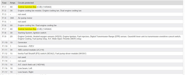

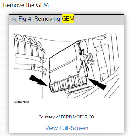

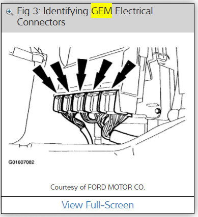

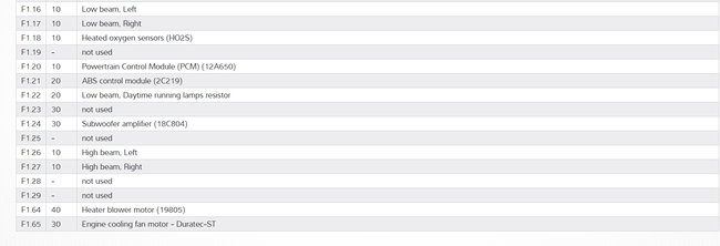

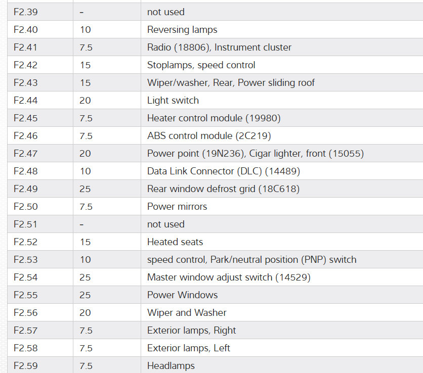

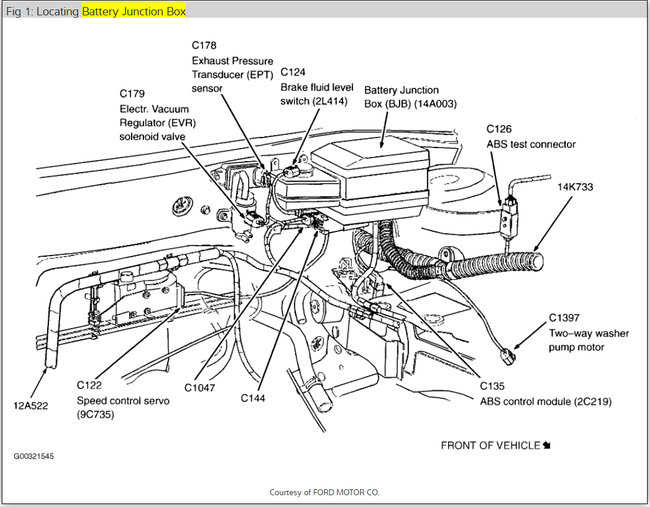

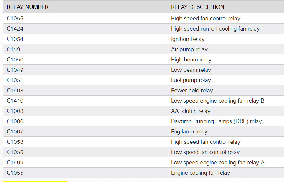

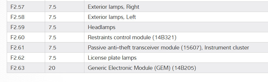

There is a battery saver relay I would check because it might be stuck closed also there is a GEM module which controls these systems as well.

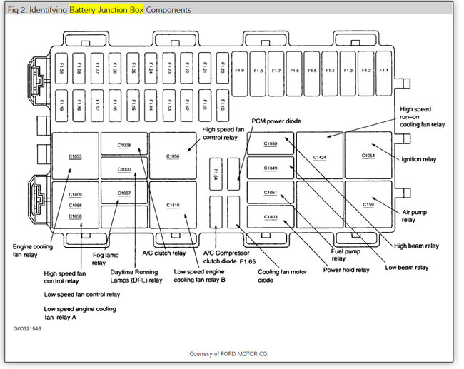

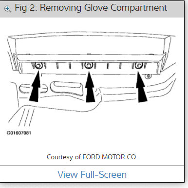

Here is a guide and the location of each component so you can do some testing.
Please run this test and get back to us.
