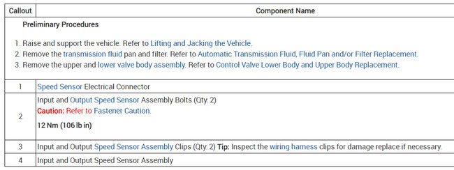

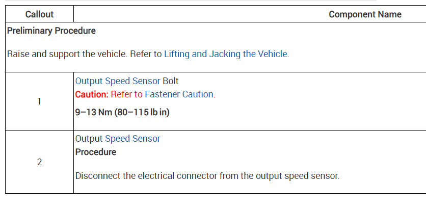

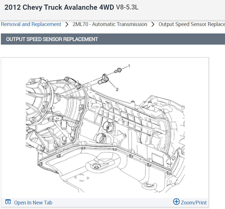

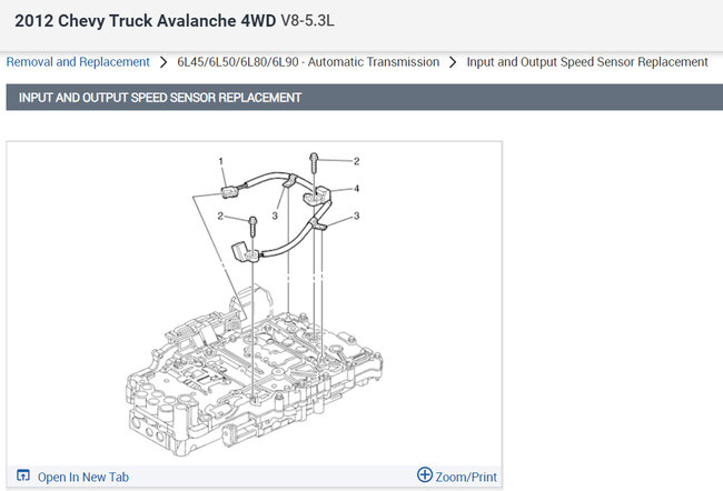

Nine times out of ten it will be the vehicle speed sensor (VSS). There is a chance the cluster needs to be rebuilt or the PCM is not processing the data correctly as well but let's stick to the easy and most obvious stuff first. There are two different transmissions so here is the location of the VSS so you can check them out. Check out the images (below). Let us know how it goes.
