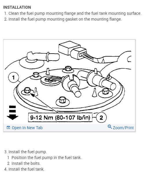

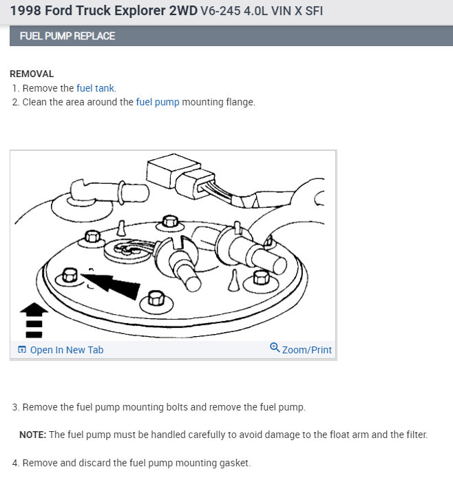

https://www.2carpros.com/articles/how-to-replace-an-electric-fuel-pump

Thanks for the quick reply. I've been searching the internet and educating myself on this matter but could not determine for my 1998 Explorer whether the fuel gauge sending unit was part of the fuel pump itself or separate. I'll head over to the dealer tomorrow.
